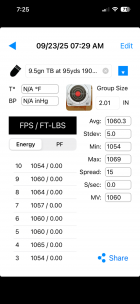

Started trying get the 190s to shoot subsonic in 308 Ruger American. The 322 and 4885 both shot well at 1050 but both seemed loud to me. Tried the Titegroup and settled on 8.1 at 1040 as a good quiet load that shoots pretty decent.
Here are some results I had with TB, these were 190 sub x

I also load the 190 Sub-X over 8.1gr Titegroup. The suppressed 20" 1:10 twist Rem700 sends it at ~1080fps and they are reliable 1 MOA loads. I pressed out to 300yds just for fun and it ignored the wind.
I also have 175gr subsonic plinker loads over 7.5gr Titegroup that go ~1080fps, too. They also stay 1 MOA at 100yds and are stable out to 200yds.
