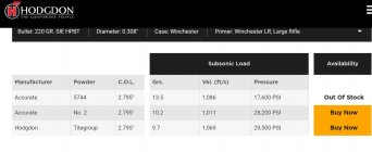

Thank you all for your help! I don't remember who made the bullets I purchased, they were on sale for cheap and I got 1000 of them. I have a good NOE mold but these ended up being something like 16 cents each. I have 2 of the 2 powders listed on that chart. I want to get some H4895 (How come no matter how many different powders I have I always want one I do not have........
Thanks again this gives me a place to start. I went to hodgens site and I even saved the pdf they had but they did not have 220 grain listed for 308. I will go look again.

There are published subsonic loads for jacketed bullets in Hodgdon's reloading data.
I started a thread on exactly this almost two years ago. My conclusions are titegroup and Red Dot are the best non-trail boss powders..
