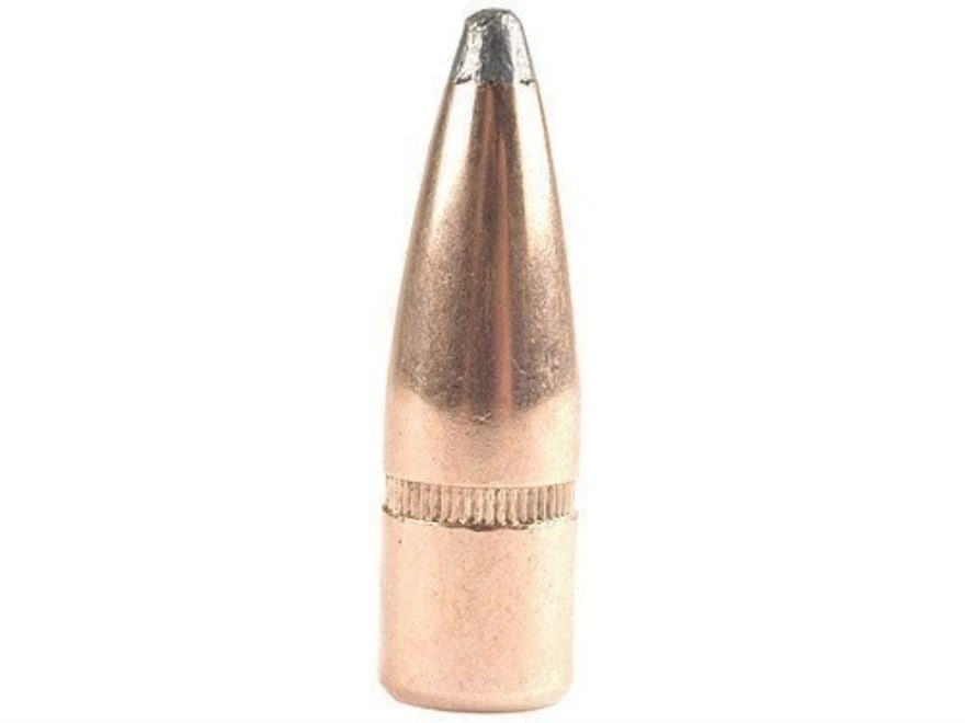

How big are the hogs, and how far away? In most cases a soft load on a 150 grain Hornady RNSP in and around 30-30 velocities on the low side, up side + 150 FPS will work. They're reasonably priced and my sister in law has killed pigs, bear, deer and several other species with a soft loaded 30-06 for 40 years. Accuracy is not varmint or competition grade but if you miss a pig it won't be the bullets fault.

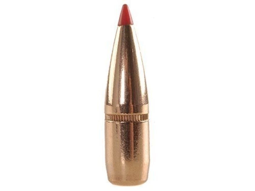

Hornady 150g FLAT BASE, 165g FLAT BASE saw up hogs like cord wood! OP, since you are used to shooting 175g bullets, Hornady 180g BTSP would be first on my list.
