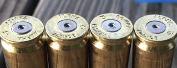

. Maybe it's me, but the 3 with primers from the 44.8 dont look over pressure to me - but like i said im new to this.
No matter what the manual says max load it isn't a fixed number. I believe ejector swip mark can only come from high pressure. The case head is getting pushed into the hole. Strange you have low fps. I would try a different powder. Look at the load maps in the technical section. No obvious answer. You might have a tight barrel?

I found a few videos and articles that said howas struggle with this issue because of how large the firing pin and hole are
A larger-than-necessary firing pin hole would be more likely to cause pierced rather than blown primers, and I'm not seeing the kind of cratering in your original primer pics that might be expected from an over-sized firing pin hole. Nonetheless, it is a good idea to have it bushed if you think it is part of the problem. It won't hurt anything to have that done.
I went out today and loaded up 35x rounds at 43.8 grains of the staball Match powder. This was the middle of my node from previous testing
I was testing for seating depth and loaded up 35 rounds 5 groups each .005 farther from the lands. I loaded up 3 batches each with different primers. Winchester, CCI and federals
Out of the 35 in each batch, I blew at least one primer in each batch of 35. Groups were best at .030 off the lands for all the primer types
I plan to download my chronograph data when I get home but from what I saw the velocity was all in line.
Again no pressure signs on anything except the ones that blow a primer out.

The Hornady data was shot with Win cases. The Winchester brand is rather well known to usually have more internal capacity than other brass. Lapua brass is smaller inside which will yield higher pressures. Why are you working down from a max load to start (in your 1st post) ? Start loads are called start loads for a reason.
To blow a primer out... gonzo... not there... you have already passed the threshold of marginally safe by 15-20K psi. The ejector scrubs show up around 10Kpsi over safe max. I dont care what some jamoke on the internet, your brother in law's cousin, or U-tube says, primer appearance is not a real good way of determining pressure unless you are very familiar with the characteristics of the particular lot of primers you're using. It seems you're not. Unless you have some way of measuring pressure you're treading in dangerous territory. Being new at this, but not heeding what your rifle &/or brass is trying to tell you is foolish at best. Slow down & think. Formulate a smart & safe plan of moving forward rather than the Rick-o-shay Rabbit method of problem solving.
Have you called Hodgdon to see if there is a hot batch of Staball Match? It's a relatively new powder. Maybe some #s got transposed in the manual? Shit happens. I locked the bolt on a 35 Whelen a while back with a start charge of 4320. It happens. Reloading manuals are but guides. Almost guaranteed that my stuff is different than your stuff which is different than the stuff they shot in the pressure gun at the lab. Max is not necessarily what the book says.

Unless you have changed something in you brass preparation its unlikely that is going to be the issue. It would take a significant change in the case datum dimension to "blow a primer" out of the case. If that were the case you most likely would not see ejector marks. The primers are loose in the pocket because the case head is expanding. So you are left with the likely suspects of powder lot or bullet change. In this case I suspect the problem if it exists is in that area.
Since this is a commercial barrel/chamber I would forget about 20 thousandth and load to 2.800" COAL The reason is to insure that you have enough bullet in the case to prevent premature release and lodging the bullet in the lands. I'm suspicious that this is the case from looking at your cases. You show clean brass than your ugly cases. This make it look like an inconsistency (large) between the fired rounds. If you still have pressure signs at this level I would think the powder data is suspect.

I just got off the phone with Hodgdon and he suggested the same thing.
He said that im probably right on the edge of the bullet wanting to stay in the case and then lodging in the lands. It's become a problem with the 168's because they are a smaller bullet than the 175's.
He gave me some things to measure and i will measure today. I also plan to start at 2.800 and look from there.
He also said to not use Magnum primers - said this can cause the pressure to increase too

Define "popped" primers. Popped to me means they were not in the case after the shot. Did the primer fall out of case during brass ejection? They can't really come out of the pocket while the bolt is still closed. Popped could also mean what most call blown, ie: a hole in the primer where the firing pin indentation is and lots of smoke. Either way the ejector marks signal high pressure.
Frank
Frank, I dont see ejector marks in his pics. I have seen mine, and there is an obvious cylindrical scratch from rotating the bolt. Easy to spot and obvious. Can you clarify on his pics ?

I bought a Hornady OAL gauge and modified case. I also have the tap and drilled/tapped a Lapua fired case from my rifle.
They both measured the same and that my chamber is 2.950 +/- .005 to the lands
this compared the the method i was using, means i was basically putting the bullets into the lands (was loading to 2.940ish
I will be going out to the range Saturday, and will be starting at 'ground zero' again. I will load to load data length which puts about a .150 jump to the lands.
I will start at the bottom again and work my way up. The rifle is as clean as it's ever been so there should be no carbon induced issues.
