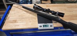

I have a fairly lightweight 300wsm I bought for hunting. Built by rifle Inc back in the day if memory serves me correctly. Originally had a Swarovski 3-9 and I wasn't running the recoil pad and was right at 6#. Now almost 7# with the pad and leupold. I think this was a #1 contour, again, if memory serves me well. 20231213_203415.jpg20231213_203424.jpg
Honestly not sure. I'll pull the recoil pad off tomorrow and see if the factory pad indicates. It has gotten gummy over the years and the slip on pad was more to hide that but the extra gel helps if you know what I mean lol.
