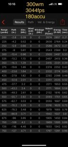

Found a decent load with 71.2gr of n560 with the accubonds and gonna work down to about 70.3gr with those. The 71.2gr gave me 3044fls over 3 shots average and single digit sd and es numbers.
Overall I’m pretty happy with it so far. But definitely want to tighten things up. These were all loaded at 3.340. I loaded some up today to try next days off at .050 off the lands. In my rifle lands are at 2.950cbto and still fit in the magazine well. I’ll use that length for the 220s and maybe 190s to see if it improves any.
