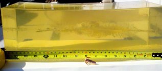

Here's one of the subsonic gel tests with the 200 gr. Maximum Expansion bullet - you can see the maximum expansion and energy transfer is happening after about 3" into the gel and stays that way until about 9" with total penetration to around 17") - - - knock down projectiles!
Robert
