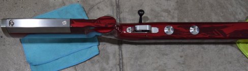

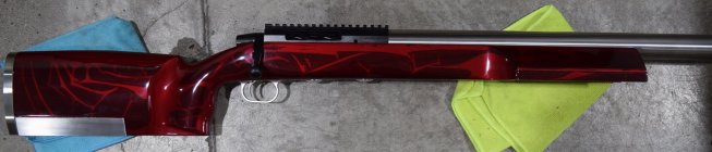

300 SAUM Imp. 600/1000yd HG
Seems like I have been building as many of these HGs as LGs lately. This one was built on my heavy fill LRB stock, with some weight added as well as a steel rudder and butt plate. Action is a dual port Bat M glued and screwed, with my usual bolt and ignition work. Trigger is a B&A. The barrel is a 1.450" straight Krieger chambered in my 300 SAUM Imp. #2 with a Harrell's brake. Ended up 35 pounds as pictured. Balances 1/2" in front of the action and will end up a little farther back once the scope is mounted.
View attachment 1316880View attachment 1316881View attachment 1316882View attachment 1316883View attachment 1316884View attachment 1316885
man that is a work of art mechanically and paint work.
