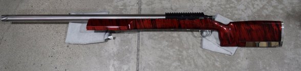

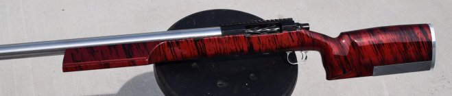

I just finished a pair of these but forgot to get pictures before I shipped the other one. These heavy guns built on solid glass filled LRB stocks have been pretty popular. I can get them up to about 30 pounds and its nice you run your LG rests. This one is a Bat M with flat bottom. I have tuned up the action and trigger and glued/screwed it into a solid glass LRB. The barrel is a 30" 1.350" Kreiger in 300 saum imp. This one I got try out a color I thought would look good. Its a tri coat with 2 different pearl colors in the base. DSC_0223.JPGDSC_0225.JPGDSC_0226.JPGDSC_0227.JPGDSC_0229.JPG
Very nice work :). That pattern would would work really good in camo colors for your hunting/Varmint rifle builds as well. Probably one of my favorite paint pattern you’ve done.
