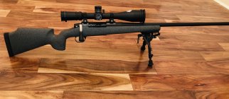

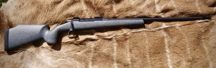

Here’s a couple of pics of the 300NMI that Alex built for me this past summer. Needless to say but the fit & finish are excellent. The rifles intended use will be for elk so I wanted it to come in on the lighter side and keep the overall profile thinner and more practical. Ive held off until conditions were closer to hunting temps before tuning. I should be able to get it out within the next week or two so will post results after each range visit. Specs are listed below.
-Bat HR action
-Krieger #5, 1:9, 24” barrel (Cut 1” from shank & 1” from muzzle)
-Mcmillan game hunter stock
-BixnAndy tac/sport trigger
-Beast brake
-Hawkins BDL bottom metal (wyatts box)
-Rifle weighed in at 8lbs bare & 10lbs3oz scoped.

Yeah the Beast brakes are amazing at taming recoil. I have the 4 port titanium beast on my lightweight carbon fiber 300 NMI. A small child could easily handle the recoil.
Total weight with everything except a scope and rings is 7 lbs, 7.6 oz.

Love that set up! Thanks for posting, me and my cousin both have similar set ups being put together by Alex currently. I’m glad this thread is up and going, should make things easier when we get the rifles.
