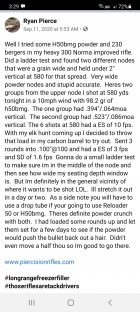

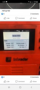

Here it is on the h50bmg. Thought you would like this. I was thinking that with a 245 berger or 250 atip the h50bmg may be decent. And more so if I run at least a 30" pipe. He only had a 26".
For the 230's on up Kyle, - I'd go with the H50BMG rather than 24N41 and never look back. - H50BMG is a good powder in over-bore and large capacity cases - period. - I love it in a 35" barrel in 30-378 with 230's.
