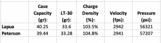

Measuring the case volume of the three pieces of brass, and comparing them with a (different) lot of Lapua .30 BR from earlier in the year...
The case volume disparity might not seem like much. But it makes a difference. If you had a load of 33.6/LT-30 behind a Berger 115 that you wanted to transition to Peterson, you'd need to drop the charge to 33.28 to get the same velocity. You'd get there, but at the cost of a somewhat more compressed load, and a bit more pressure.

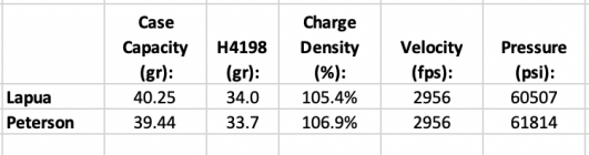

Here's what it looks like with a 34.0/H4198 load...
As a general rule of thumb, it looks like Peterson brass will require about 0.3 gr less powder than comparable loads using Lapua.
