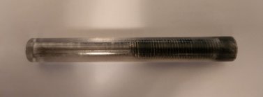

After trying the spring, I ran across a tip about threading the inside of the tube, which causes the powder to spin, slowing it down. Somewhere in my mess of tools I have a long shank tap that worked for the smaller ID Harrell's drop tubes. You don't have to do the whole thing.
Added picture. As bad as it looks I find that the black stuff helps reduce static charge buildup in the measure.
