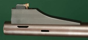

As for Brake hate the loudness of a brake I have a few but prefer the Mag NA Port it’s a little less effective than brake but much easier on the ears when hunting.
