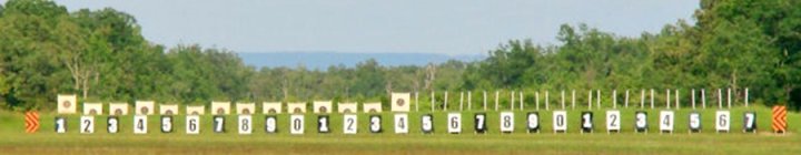

First, I would like to thank the 16 brave souls who attended the first 1000 yd match at AEDC (Tullahoma TN) in quite a while. Covid and its after affects, has really affected the availability of range dates. hence the reason we utilized this particular date.
The AEDC weather gods did not disappoint, and conditions were challenging at times. The wind and lack of mirage made for some interesting comments during the match, to say the least. The last relay of the day, for those who actually fired it , showed why putting up canopies is always a good idea at AEDC. Also take note, we had 16 shooters and only 11 scores reported. Some shooters didn't want their scores reported to the general public. Attached please find the scores for last weeks match.......... Tim MidSouth Marksmen

I believe that only you and I were "those that actually fired it", Tim!! Luckily, I had been able to leave my rifle set up on the firing point underneath my shelter-half the previous relay. It was an easy matter to quickly pull back the shelter-half and drape my clear plastic rain cover over the riflescope and place my ammo box under it to keep the ammo dry as the rain was pelting down. Only trouble was my monitor would not work under the plastic?! Many thanks to the gentleman that knelt down off my right shoulder and sheltered the monitor under his chest from the rain throughout the relay and got his ass wet. I would call that RANGER weather!

Thanks so much for running the event Tim. Shooting in the last round was hilarious. Rain coming down sideways and scope looked like someone smeared Vaseline over it. I rather enjoyed it. It reminded me of being a kid out in the rain when you didn’t care if you got wet. I only made it 55 miles driving before I had to stop to change every stitch of clothing I had on, right down to my underwear. Then hop back in the truck to complete the other 650 miles driving. I arrived home around 2am
