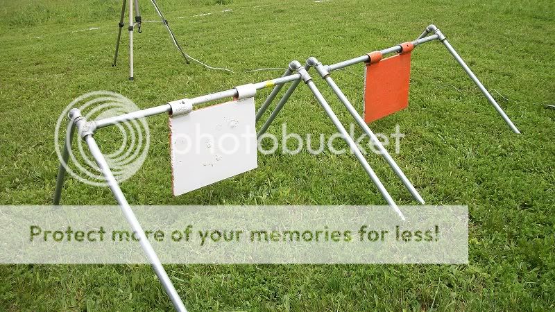

Robert, its 1/2" pipe and there is 1/2" rebar inside the horizontal pipes that allow the steel to swing freely. Comes apart for easy transport, too.

Thanks, Al. I bought 1/2" black iron pipe to save a couple bucks. Now I have to paint it. I should have bought galvanized. A piece of 1/2" galvanized pipe is U-bolted to the steel. And a 24" piece of 1/2" rebar is inside the horizontal pipes. I can spread the legs out more than in the photo and if I used a 48" rebar, I could really spread the legs out.
Very portable AND I can break it down for transport in my motorhome while traveling.
Congrats on the tight vertical -- that's got to be satisfying. I like your Gong set-up.
This is the first time I've seen a vertical and horizontal line placed on the steel. (Is that tape or black paint?) Great idea! (Slaps forehead -- why didn't I think about that years ago!)
Bill-I had a post on another LR forum a couple years ago, and got a bunch of great ideas from some folks on gong targets. I saved the post. But, I think I can get rid of it. Yours is the cat's meow. And I'll use your idea on the galvanized. Thanks again for posting.

Boss, I mask off the areas not to be marked, then use a wide magic marker to make the lines. I have some narrow red electrical tape that I use to cover the black lines when I re-paint.
My current setup is "version 3" and it works well for my mobile lifestyle - being able to disassemble when we move the motorhome.
Here is "version 1" which is mild steel and all dented up. A friend is currently filling all the dents by welding.

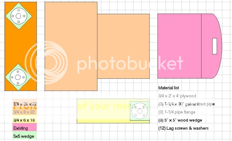

Lurcher, here is my portable bench, "version 4". Version 5 is in the works. It will not have the step up in the rear which was good when I used a front rest but I now use the short bipod. The new one will be flat and about an inch longer. One 2x4x3/4 piece of plywood will do the wood part except for the wedges.
Lurcher, here are the plans and material list for the portable bench. Legs unscrew for transport.
