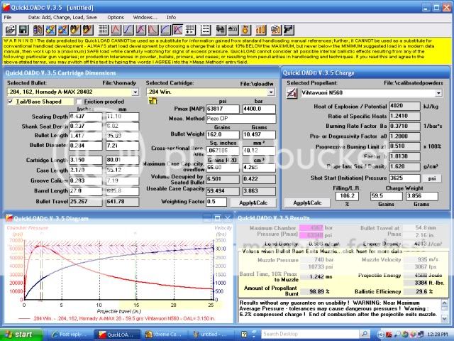

What water capacity are you using for cases? The 66.0 default QuickLOAD capacity is probably a little low. My Winchester cases are 68.4. Also, what seating depth are you using? I seat Berger 180 Hybrids at 3.265, -.010.
I used the 66.0 gr. H2O capacity, with the 162 AMax seated at a COAL of 3.150" with a 27" barrel. 59.5 gr. of N560 show 3067 fps. 63,339 psi. in 70 degree temperature and 106.2% case fill ratio.

I am using 3.1" COL. If I add 59 grains, I get 67,000 PSI; can you really get 59 grains in there?
If it is really this good, I am junking this 7WSM as the extra 11 grains actually hurt you!

I don't know what parameters you are using, but here is a screenshot of a .284 Win. with 162 gr. AMax and N560 with a COAL of 3.150"

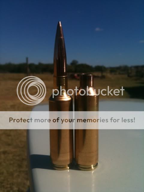

It's a wildcat based on the 7mm WSM, I pushed the shoulder back and ended up with about the same capacity as the 7mm RSAUM but with a 35* shoulder, a longer neck and better brass options.
Here is the 7mm FCM next to a piece of Norma 270 WSM brass.
