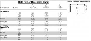

LR primers actually have fairly uniform cup thicknesses. The cup can be drawn to a little harder material condition but must remain sufficiently ductile to allow obduration and accommodate the firing pin strike without fracturing. The attached image is the old Calhoon chart showing primer cup dimensions. While SR primers are all over the place, LR primers are pretty uniform. [br]
I agree with your statement about CCI BR2 performance characteristics.
