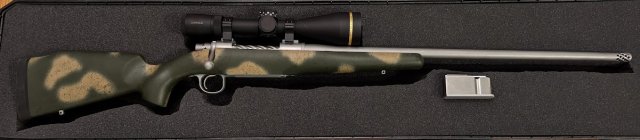

I have a Cooper M52 in 280 AI with 24", 1:9 ?Wilson barrel. I've worked up 160 gr Accubonds and 142 gr Hammer Hunters with H4831sc. Both shoot <1/2 MOA all day long. Love it!
