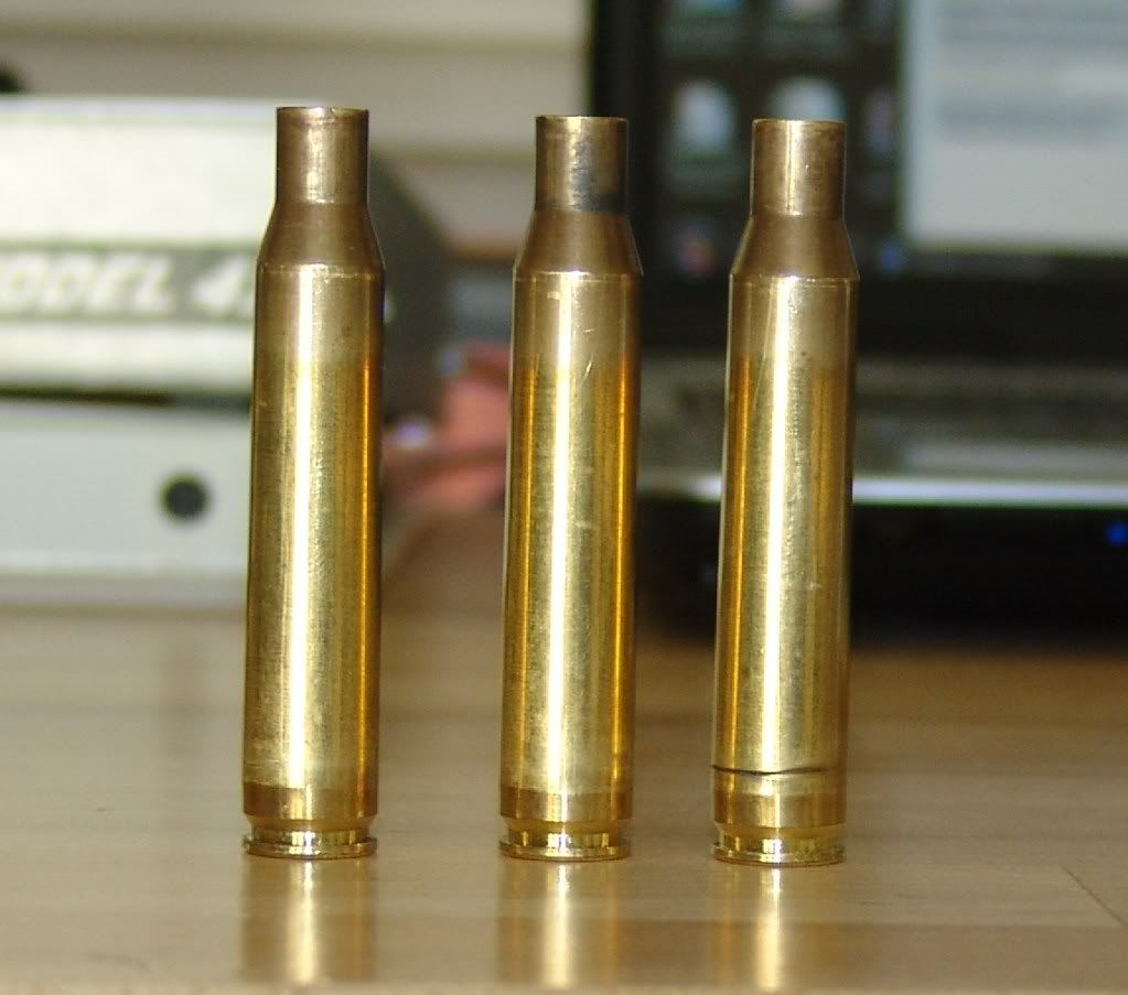

i use lapua brass in my 280, i just run them through the 280 sizing die then load them to where i have to jam them into the lands, fireform them that way and then i'm good to go. jamming into the lands is the key otherwise there is a good possibility of head space failure, see right
30-06 head spaces shorter than 280AI which makes fire forming tricky. I have the equipment to hydro-form Lapua 30-06 brass to 280AI thus saving the extra shots through a new barrel.
