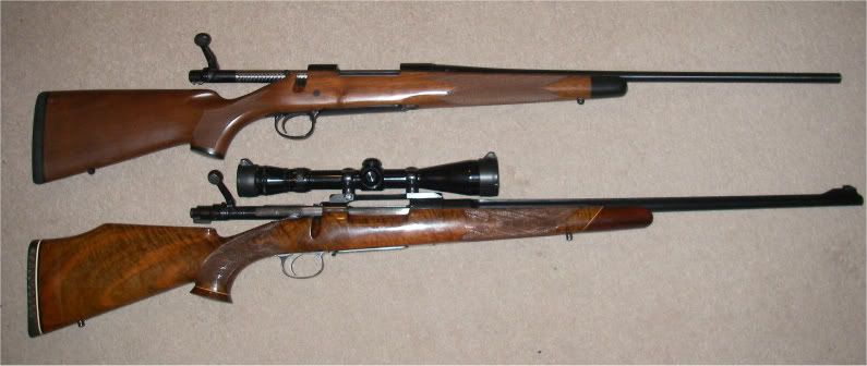

Owned a great-shooting 257 Roberts for decades. Fancy gun based on a Mauser action and raised-solid rib. Always wanted a "beater". Motorcycle ride yesterday and wife wanted to stop at a pawn shop.
OK, here's the new baby Remington BDL BRAND NEW... scored for $500.
To the thousandths the chamber is identical to the old Mauser as I shot/cleaned it 6 times and measured. Neighbor has a hole in his garage floor for that.
Next step is bedding and trigger work. Scope and mounts are ordered but what about new brass?
My decades-old Remington brass is good. Heard the new stuff is not so good. Neighbor bought new Winchester 25-06 brass and it was .008 or more below specs causing him to fireform first.
What should I get for 257 Roberts brass?

This "beater" has already been shot 26 times. Using a slave scope and old mounts I found in the "junk", it shot ammo from the Mauser 257 into 1 1/2" groups. Now that's shoot, clean, shoot clean etc. No flyers and all I did so far is free the barrel and adjust the trigger.
Can't wait to bed the action, fit a decent scope and taylor ammo for it. Build date was April of 1998. Remember it was new/unfired from that pawn shop.
