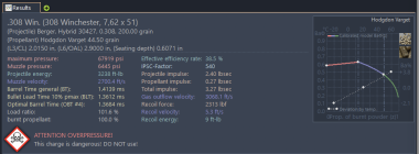

Obviously this is a simulation and may not be perfectly accurate. It helps to true it to MV and use the actual case volume for your brass, but I've found it usually in the ballpark for most parameters. I highly recommend GRT, it is much more user friendly than QL, has more functionality and is actively updated. If you do the Patreon you also get excellent support from the author and more frequent updates.
I really like the information and layout they utilize. I sure can’t miss the warning notice. There is probably some very limited wiggle room in play with choices regarding the throat in each barrel, rifling, diameter, etc., but generally not a lot.

So it looks like maybe the calibration is a bit off given the numbers you provide, because this is the default sim:
When I recalibrate using 2700 @ 44.5, we get this:
That’s probably right for TR loads, after all federal gold medal match factory ammo attains only that same velocity with a much lighter 168 grain bullet.

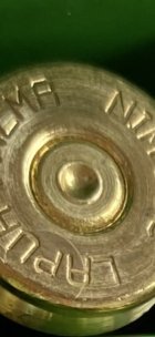

That’s a single gun issue as opposed to general load question, and as to the second, I did fire rounds with both 48 and 49 grains of 4350. There is no hard bolt lift whatsoever with either charge. You’d never know it hadn’t been a factory round. To me, recoil was not bad as I could easily watch the round impact by the rise of splash at 600 yards behind the frame. It takes a long time to arrive.
CCI 41’s and Palma brass can handle a lot of pressure, and the barrel being new provided a little more resistance. There is no gas leakage or edge squaring of the primers, but they do crater. Interestingly there isn’t any real appearance difference between 48 and 49 grains. Because that bolt has a plunger, there is the faintest of a circle’s shadow that enlargement reveals, but it is not close to high enough for any brass shearing or smearing and is actually pretty hard to see unaided.
Less powder to tune an accurate load with and more easily seat bullets is the near term goal, but is nice to know that nothing dramatic is going to occur with 4350 and 41’s. I would not use any other primer though.
This is a close up of the cratering with 49.0 grains of 4350 with the 250 A-tip. Too much powder and actually difficult to bullet seat. Over pressure, but probably not quite meeting the expectations of pressure signs for that load, at least mine. Some of my rifles show similar cratering with factory rounds.
The plunger circle is apparent. It’s something of a biased indicator because a lot of bolts don’t have a plunger hole, but would leave that mark if they did, with the loads run.
My experience since moving to custom actions and tough brass with small rifle primers is that looking at the primers doesn't tell me anything until it's too late. I find bolt lift to be the best indicator now. Safe loads extract like they went in: smooth with no effort.
