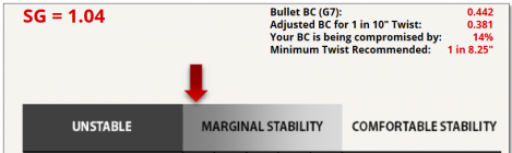

I’m going to say no to a 1-9 twist for the 250 ATIP. I’m running a 1-9 twist and have shot the 225 ELDM, 230SMK and the 230 ATIP’s and all have shot excellent. Only shot the ATIP to 430 yards so far. I’m running them out of a 300PRC at 2900fps.
The 250 ATIP per Hornady need a 1-8.5 twist minimum. According to my twist calc’s I’d go with a 1-8.25 or even a 1-8 twist.
A 308win and at lower velocities and now throw in temperature/environment conditions being a variable.....a 9 twist won’t be enough in my opinion.

From Berger:
The above is based on the original supposition of 2400fps. As Frank states the better bet is either the 8.25" or the 8.0" twist.
