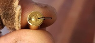

This is what is creating the slight dome on the face of the cartridge after it has been fired...look at the picture of the bolt face and what the red arrow is pointing to. Brass is flowing into that small beveled opening after firing. I assume that beveled "hole" was necessary to hold the bolt body in place between centers during some part of the machining process. The dome on the case head is only 0.0005 tall but it looks like more than what it actually is.
Gene
Excellent, thanks for pointing that out. I looked at the bolt face and it never even occurred to me to consider that. I appreciate it.
The older 2500X do not have that shallow indent in the bolt face, but I noticed that the last 3 new 2500X that I work on did have that indent in the center of the bolt face, they were PQP manufactured so it may be something new in the design (manufacturing) of the bolt, and when testing, they all marked the fired cases like cavedweller60 is doing.
As stated by GAnderson, the pressure inside of the fired case is making the soft brass flow into the indent in the face of the bolt.

You are correct. I had an early Trident action and the bolt face did not have this. I have 3 2500X's and they have been purchased in just the past 3.5 years and they all have the indent.
