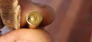

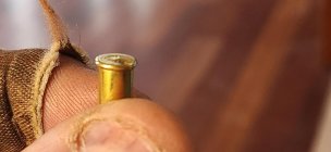

I tried 3 lots of center x, two lots of Eley match and 1 lot of tenex and non of them give consistent repeatable results. In looking at the spent casings, the firing pin is hitting hard enough to make an apparent deformity to the rim of the spent casing. The center x is also showing a bulge in the center of the spent casing which I have never seen before on any of my rimfire guns.
Here are a couple pictures....
You can see the little bulge in the center and the difformity of the rim. Maybe this is completley normal but, I can say I sifted through the empty brass buckets looking at brass and I looked at a bunch of casings from the guy shooting next to me and I didn't see any other Lapua ammo with a similar bulge. Like I said, it might be completely normal. If I had seen it on one lot of CX I would wonder if it was an ammo issue but, it happened to 3 different lots.

Your hit is not excessively deep but I’d go with the spring trim.
If you know what you’re doing you might also give the pin tip a bit of angle to bring it in from the rim a bit.

Have you ever noticed that bulge in the center of the head? You can almost tell in the second picture but, it almost looks like the center of the case head is being plowed up by the strike.
Me, I have not, however, from the lateral image no obvious bulge I can see.
