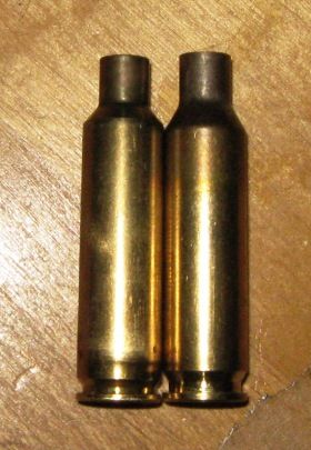

250 savage AI formed from 6.5 creedmoor
before firing and after firing of case. seeing that winchester only make 250 savage brass once ever 5 years the 6.5 creedmoor brass is a welcome alternitave. brass weighs 1 gr less than the winchester.

in the past i too have formed from 22-250 but feel there is less stress on the necks forming down from 6.5 rather than up from 22-250.
loads were plenty good enough for hunting when fire-forming.

Ordered some 25 Creedmoor brass to form into 250ai. Looking at drawings, it appears the body will squeeze down about .005 and the shoulder neck junction moves back a few thousandths. A outcome will be that permissible pressure of 250 should go up as the creedmoor cases are made for 62,000 psi and the savage was 52,000. Will still be working up slowly though
Update on this. Bought alpha 25 cm brass and reformed. As i approached max loads i started getting clickers. The case head on cm brass is .470 and 250 is .467. Aside from that it worked great. I suspect hornady took the 250ai and put a 30° shoulder on it, 308 head diameter and called it a cm considering how accurate the 250ai is

Im not necessarily referring to each detail. There is .007 wider shoulder, .003 wider case head on the cm, very similar. Put them side by side, very little difference In the 250ai and 25 cm. Cm brass works in some 250ai chambers and some not. It depends on how tight the camber is cut on the ai. Clickers are when brass expands in the head area and becomes tight in the chamber and the bolt has to cam out the empty and causes a click. It happened in my rifle.
