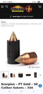

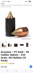

Try these they are accurate and deadly i use theseView attachment 1703745View attachment 1703746
