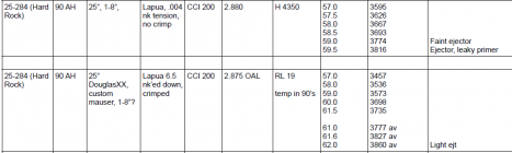

I am partial to the 25-06 because of the way it killed my first whitetail buck many years ago. But will add that I often think of building a 25-284 because I really like that case sized up or down. I currently have two 25-06 rifles, a 700VS and a 1V Ruger. With the advent of StarLine 25-06 brass I may have to think about another one
