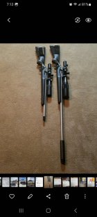

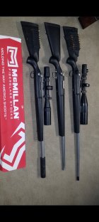

Liked it so much I built 3 of them for me , and 4 for other close friends. 105s are Aoudad killing machines out to 780yrds. And it did really well 600 yard f class as well
