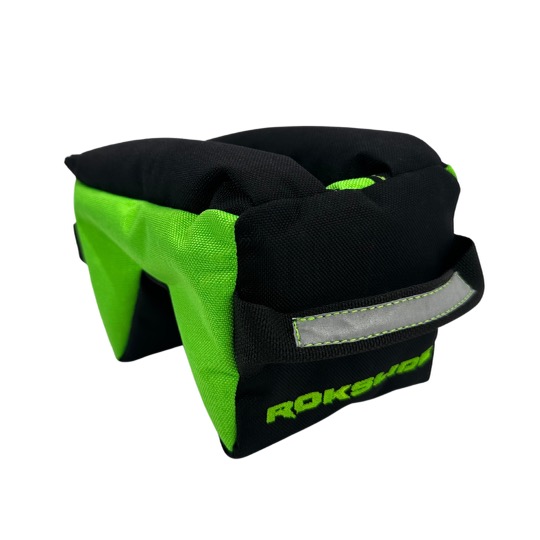

What kind of bag do I need to get

I always have a bag for rear support while hunting. There are light weight bags that you can clip on your pack. You don't have to have a dedicated bag, you can use your bino pack, or a coat etc. But you need rear support.
This is the bag I carry it's 4.5 oz. and very versatile:
The problem with rear bags in actual hunting situations is weight and/or bulk in carrying it around. I use a small leather bag (about 4" x 4" x 5") that is about 85% filled with small plastic beads. They are commonly known as "squeeze bags". Once you are aiming at target, you squeeze the bag to bring the crosshairs down, relax it to elevate them. Sinclaire (now Brownell's) used to sell a great leather bag. I'm sure there are other companies that make them. If you (or wife?) are handy with a sewing machine, you can buy the small acrylic or polyester beads on Amazon or Etsy and use some old denim from some worn out jeans (or leather). Nothing high-tech about it, but is light and very portable, fitting in jacket pocket.
