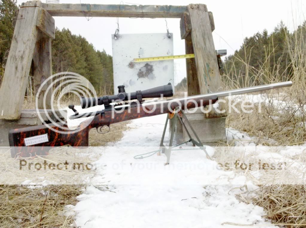

Round count in my 243AI is just under 1000 right now and it's still shooting well. I don't know what the throat looks like but I just shot this 5 shot group at 705yds last week while laying in the snow.
Sorry (grin)
Specs are:
Rem700 S/A that this is its 3rd barrel
Rock 5R 1-9"tw Rem Varmint Contour at 24"
ADL A5 50/50 Black/Orange
Older Leupold VariX-III LongRange (pre-Mark4) 3.5-10x40 in Seekins rings/rail
Running 105VLD's from the mag at 3200+ via '17 in Lapua brass.
