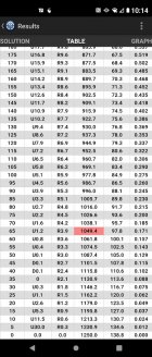

Here's a screen shot of my shooter app - data was gathered using a Labradar and a chrony shooting Lapua Biathlon -X thru my Vudoo. The density altitude on this day was around 5500' and ambient temp was 87°F. I notice this distance is quite often the norm for me - highlighted 1049 f/s at 65 yards is where is goes transonic - I believe there may be a little change in accuracy at 75 out to about 90 yards but the 100 yard group is very respectable.
Greg

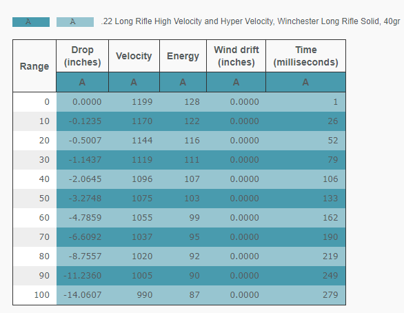

Some rough calculations with my ballistics program put it at 20 to 30 yds depending on weather. I'm 710 ft above sea level. Humidity runs 40 to 100%. Temperatures range from 60 to 80 degrees.
A .22LR round with an MV of about 1200 fps will be around the speed of sound after travelling approximately 30 yards. It's not easy to be more precise without knowing more, especially about temperature and altitude.
The speed of sound in air is about 1125 f/s at sea level at 68 degrees Fahrenheit.
