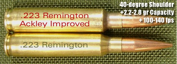

223 AI's provide a little more velocity gain than 100 to 140 fps.
