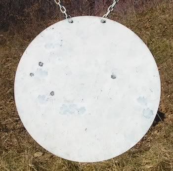

The following target is not posted as to show how great of a shot I am but to prove they are arriving pointy end first at 1000y. It would have been a 5 shot group but without knowing where I was hitting on the 36" target I missed judged the wind. I was holding 1.5 mil and should have held 1.2ish. Shots 1,2 and 3 all hit the left side while shot 4 missed. I thought I saw a minor disturbance in the force, I mean dirt, just off the left of the steel so I ended up over correcting for shot 5 by half a mil. :blush: Had all shots struck I am sure I would have had a nice 10-12” group in todays wind but instead I have 3 in 8” with a straggler.
