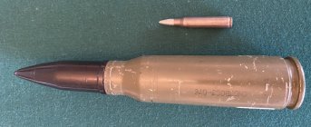

It’s everything that’s good about the .308, down to liking the same bullets. Same action will handle both. I think the two cases stand the exact same height, maybe identical neck lengths. Neither one has short barrel life. Neither one blows up bullets. Both get good SD’s. Brass primer pockets last a long time in both. Just plumper.
300 WSM (bottom)
.223 (top)
