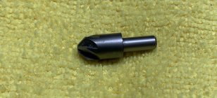

I scrounge brass at the range. Almost all the brass I find that someone has reamed the brass to remove the crimp, it has been WAY overdone. Sometimes half the depth to the bottom of the pocket. Not saying everyone does it this way, but if you are going to ream them, pay attention to what you are doing and use the correct reamer. Here is what mine look like after swaging.

I cut the primer crimp out with a 5/8" counterbore chucked up in my drill. It takes about the count of 2 (1-2) to remove it. So much quicker than swaging or using the primer pocket reamer station on the RCBS or others. I bought the reamer at Lowes, but I am sure any will do. Don't even have to press hard.

I have an RCBS Primer Pocket Swagger that I gave up using years ago when I was shooting LC cases in my 308. I found after swaging I still needed to use a case mouth chamfering tool on at least 40% of them in order to get the primer started. Maybe it was my tool or maybe it was how I had it set up, but "cutting" the crimp is way faster and more reliable in my experience.
