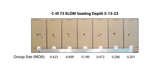

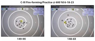

FWIW - in my hands, the 75 ELDM is an outstanding bullet in an F-TR practice rifle (26" 5R barrel, 7-twist, 75 ELDMs @ .020" off the lands). In fact, I am shocked at how well they shoot with only minor load development. I've have also used the Berger 80.5 Fullbore bullet in the same rifle. Although the 80.5s shoot well, the 75 ELDMs shoot with equally good (or better) precision, they can be pushed faster, and have a slightly higher BC.
(Note: circles are 3", which is slightly under 1 MOA at 318 yd)​
Even though I am very impressed with the performance of the 75 ELDM, I would not typically choose to use a 75 to 80 gr bullet in a 600 yd F-TR match. I used to use the 80.5s in a 300 yd monthly match, and I would certainly have used the 75 ELDMs had they been available at that time. I did reasonably well with the 80.5s at 300 yd, and I'm certain the 75s would have work very well also. Nonetheless, I would choose either the 88 ELDM, 90 VLD, or 95 SMK for 600 yd midrange F-TR matches. Why? Because anyone using a .223 Rem in F-TR is going to be competing against shooters using .308 Win with heavy, high BC bullets. The 88s/90s/95s can hold their own against .308s at 600 yd, even in fairly windy conditions. The 80-ish gr (or less) bullets...not so much. It's possible the 80 ELDM might be a good choice for 600 yd. It has a very high BC for its weight, much higher in fact than most other 80 gr .224" bullets. Its BC is almost as high as the Berger 85.5 Hybrid, and you could likely push the lighter 80 ELDM noticeably faster. However, I have never tried the 80 ELDMs and so I can't personally state with any certainty that they shoot as well or tune in as easily as the 75 ELDM.
