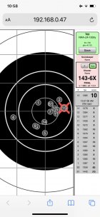

The velo at target and SD for these 88’s were much better than I expected.
An over book charge of IMR 8208XBR. All the usual disclaimers as to safe reloading and risk assumption with this data. I was at 24.5 gr, jumping 0.010". LC brass 4x fired and Fed 205MAR primers. Work up until you get pressure signs. This was in a 26" gas gun with a +2 gas system. No swipes on the brass but the primers are starting to show some flatness. I will likely back off some as it warms up this summer.
