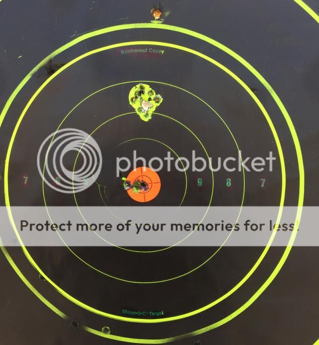

I've tried Hornady 2267's and they shoot good with just less than 1" groups at 100yds and also using IMR 4064. The AR I am getting this with is the BCM Jack Carbine with a Burris scope. Now at 600 yards I can stay in the 8's unless it's windy but then I'm using Nosler 77gr #53064 bullets.
Here's a pic of the Hornady group at 100yds.
