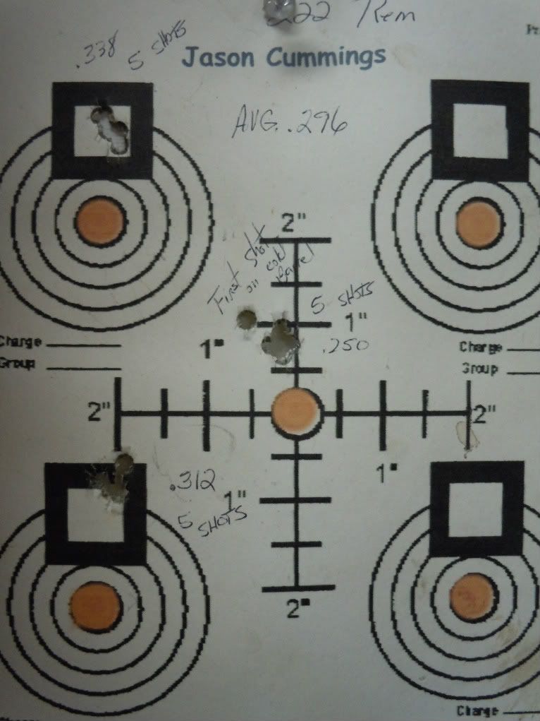

I had some loads made up using the 30 grain Berger bullet and N 120. First time I tried it this is the group it shot. Not a match winner by any means but I was happy and the light recoil using this bullet is really significant. I trier the load at 200 yds but it got moved around by the wind so much that wind flags are a must. You might want to try these light bullets as they shoot well even with a long jump.
The 222 has been my go to round for 15 yrs now. I found a very clean model 700 and have never looked back. Keep in mind that this is a factory rifle, with the only modification being a trigger job. It will shoot some unreal group's when i do my part. Here is my pet load for my rifle.
52 gr Hornady BTHP match
24.4 grs IMR-4895
Rem 7 1/2 primer
loaded to factory length
