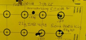

Target from this past Monday 98 degrees mild wind lost of mirage, still working up loads, IMR3031 and IMR4198 Sierra 52 MKHP and 53g MKHP
