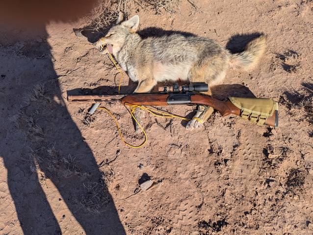

Personally, the rifle you want to build is out there, the Sako L,-461 Vixen, lightweight, great trigger and accurate Your going to end up with bulkier rifle and more than likelier heavier rifle.
Your talking "walking varminter" and it sounds like your building a "walking benchrest rifle".
Mine is the full-stock version and is one of my favorite coyote hunting rigs
An inexpensive very accurate bullet in the 222 Rem is the Speer 52gr flat base HP Varmint bullet , I buy them by the "K" around $10./100.
I put a sleeve on the front half to cut the glare
And they shoot, there are five there, four and the highball still pushing .5 MOA even with the flyer.
Both Wooters and Fadala built their walking varminters on the Sako, Fadala in 6mm-222 so his wife could use it for deer also and wooters in 25-222(25 Copperhead) so he could use easier casting .257 bullets.
Just another thought, I have a compact Leupold 2-7 on mine. The SWFA 2.5-10 Ultralight would make a great scope for a vixen as the ocular housing is small enough to use Sako Low rings. The Leupold compact can use lows but the 1-4x20 shown needed mediums.
