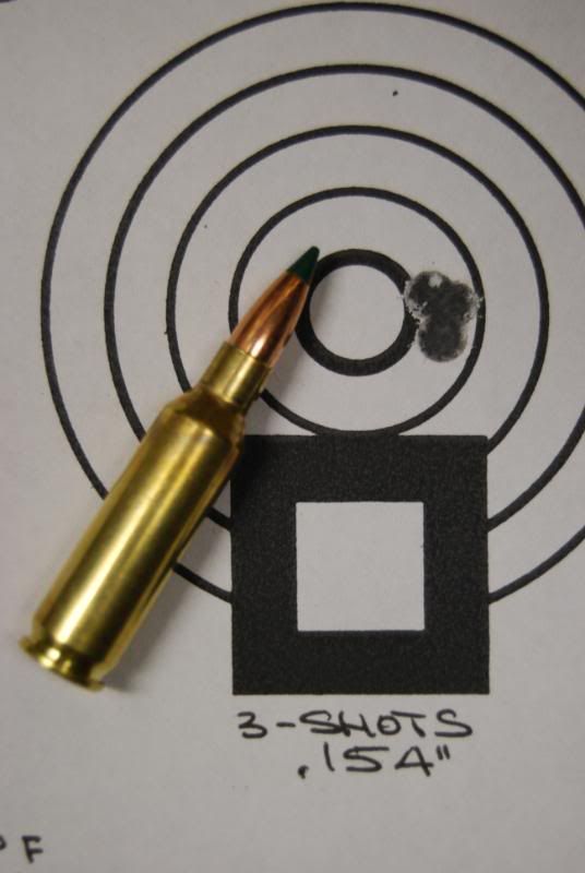

Lyle, I have all three calibers based on the 221FB case (221FB, 17 Mach IV, 20VT), been shooting varmints for almost five decades, and can say without hesitation that the 20 Vartarg is by far the sweetest varmint caliber I've ever had the pleasure of working with. Todd bugged me for five years to build one, and once I did, I wish I had done it sooner.
In my safe are 223's of all flavors including the Ackley version, various 204's, all the way down to the 17 Ackley Hornet, but my Cooper 20VT is by far and away my favorite of the lot, and I work mine in the rat patch out to 500 yards on ground squirrels here, so 200 yard precision is a given with this little caliber.
Brass is easy to form from 221FB cases, any 223 or 222 case if you're willing to do some work. Lapua makes 222 brass, as well as Norma/Nosler for 221FB, so preminum brass is available now if you feel it's necessary. If/when Lapua comes out with 221FB brass, all the better.
Here's an example of typical accuracy with the 20VT (32gr SBK/18.5grs RL-7, Rem 7.5 Primer) shot with formed and annealed R-P 221FB brass:
