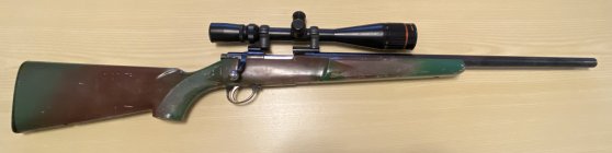

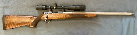

The .221 is a good one. That green semi-camo thing is a junkyard dog built in late 80's......Sako 461 gunshow scrounged, Apex 14tw from gunshow, beat up cheapo Sako stock from the old Gun List paper, ugly well used paint by me. And surprisingly good Simmons 6.5-20. Seen a lot of use on everything. Pretty one is also Sako, gunshow special I bought for the action and very nice wood, Hart 14tw from classifieds came with Vais brake installled, had it rechambered to .221.
Loads for ugly gun are:
33 Vmax / AA2200 - very nicely accurate but very low BC
40 BalTip / AA2200 or RL7, very accurate, shot gobs of these at 3450, nasty on pd's and groundsquirrels
42 Calhoon /AA2230 - very accurate and explosive, he makes a great bullet
50 BalTip / AA2230 - Not real fast but same accuracy as others.
All of these are working combos in the ugly gun, and happily I found they shoot the same in the fluted barrel which was chambered with my reamer. Both are just a pleasure to use.
