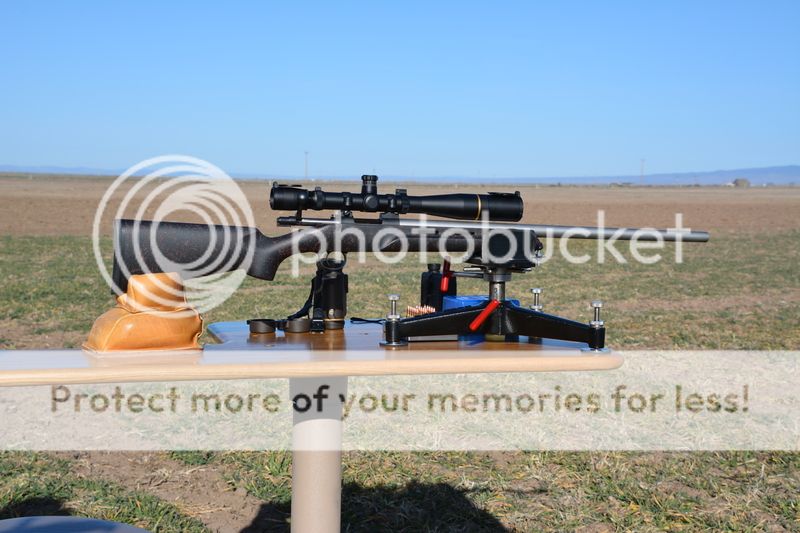

Speed for the above runs right at a tad over 3,100 fps. With that degree of accuracy, I didn't feel the need for more speed. Here's the Cooper FB in the field on the bench rat shooting here:
