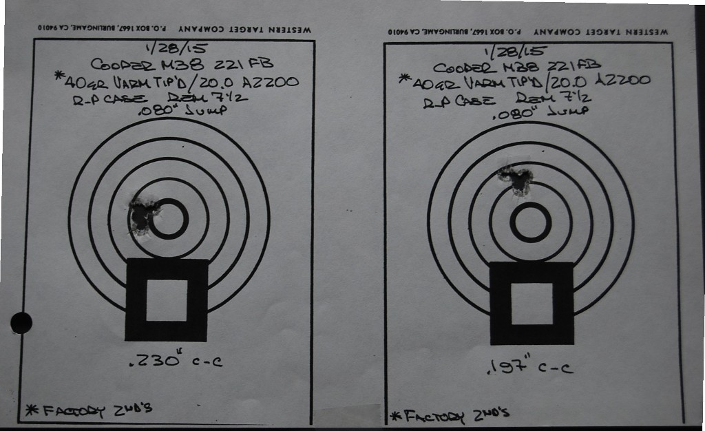

I don't shoot much paper, but this is representative of what both my Furballs will do....one a Cooper M38 VR, the other a CZ 527 American. Both shoot like this with either A2200 or RL-7 and Nosler VG's or BT's, with the same powders I use in my 20VT.
The Cooper Furball with some rock chucks that do not approve of either caliber....
My stable of 223's don't see much use any more, and for years they were the mainstay of my rat rifle battery. Love that smaller case for what I do!
