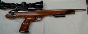

50 years ago I bought an XP-100 in .221 Fireball with the plastic stock. 35 years ago I took it out of the plastic stock. Got a Shilen barrel for it, a Canjar trigger for it and put it in a Fajen walnut stock with a Leupold 2.5-8X LER AO OBJ scope. Killed a lot of sod poodles with it. I still shoot it today.
