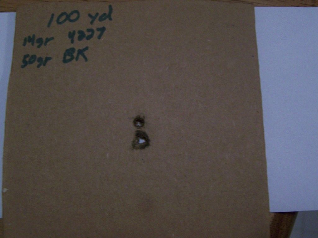

Any one can shoot 2 shot groups..
Hahaha...holy smokes!...you got a shooter...

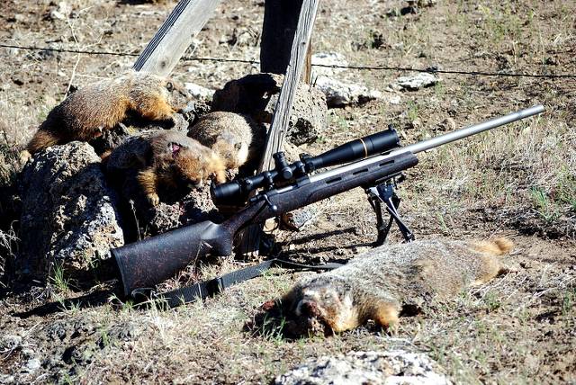

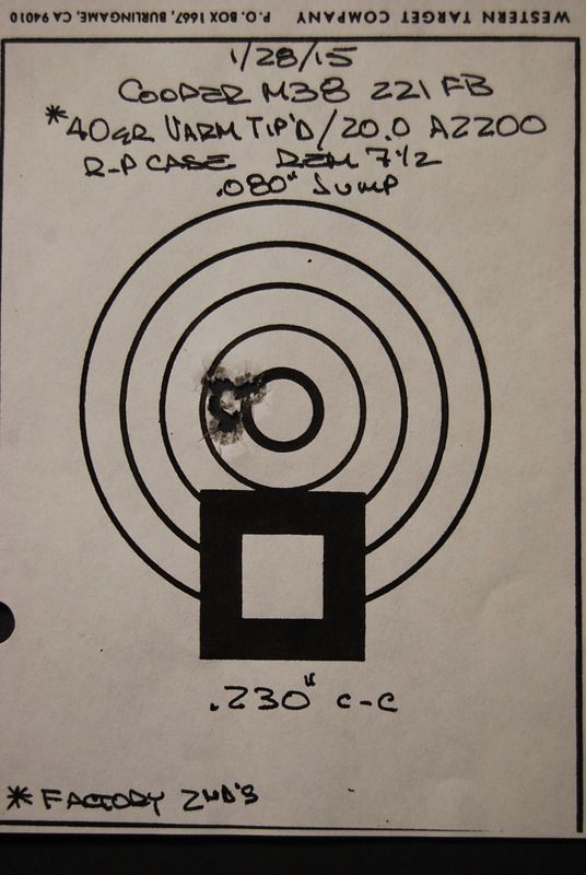

Well, I have to throw my hat in the ring. I started out with an XP100. I was really impressed at the performance I was getting out of the little Fireball. I then ordered a Cooper M38, and I wasn't disappointed. It was everything I expected and more. Like Rick in Oregon said, "it shoots with boring regularity".

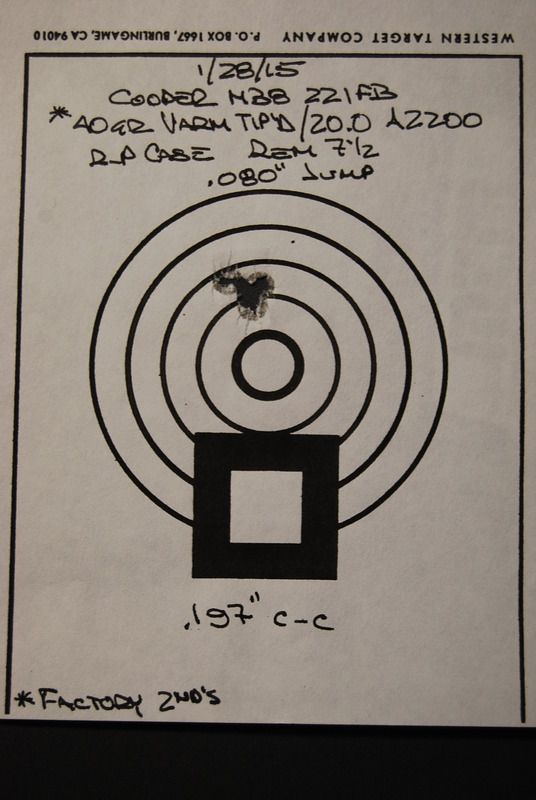

The only time I take it to the range is to see if I can still shoot. Here is a pic of the last group I shot with my rifle. 5 shot group.
Here is a pic of the rifle
I forgot to add that, my rifle all in weight with a 6.5-20x40 Leupold is only 6 1/4 pounds. It's like hunting with a Daisy Red Ryder. It handles fast when a coyote shows up where it wasn't expected.

Great looking rifle, nice kitty also

I just noticed the cat!...haha..perfect camouflage absolutely amazing animal..nice one!

I never found A2200 powder listed in print (which is usually a must see for me) for the 221 Fireball . Not a lot of BS in this forum which is what makes it great. So I decided to take a chance and give it a go. I had just bought 500 of the 40 grain factory seconds so I Loaded 3 rounds each at 19.0 19.5 and 20.0 and also loaded 3 rounds at 20.0 with Nosler Varmageddon seen on target "D".
This build was scoped with a Burris Eliminator gen 1 that I got on a trade and wanted to try it. While it is an amazing contraption the reticle leaves something to be desired for fine work. But the 2200 was looking good on target.
I decided to change out the scope to a 6.5-20x50 Japan made Simmons 44 Mag with target turrets that I snagged last fall. One of my 17 Hornets wears one of these puppies without the target turrets and it's an amazing scope in the PD fields.

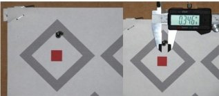

After loading another 8 rounds of 2200 at 20.0 I headed down to my shooting bench. Shots 3,4 &5 piled up at .386 and I moved to a clean target for the final 3 shots.
Great information! Any chance you ran those loads across a chrony?
