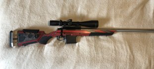

I built a .20 Vartarg (221 fireball, neck down to .204) on a 700 short action. The action is from Pacific tool and Gauge, and the bottom metal is a stealth M5 that came with an AICS 5 round magazine.The feed lips on the 223 box magazine are too short to keep the round from popping out prematurely when sliding forward with the bolt. Having troubles finding a solution to the short round/Short feed lips for the .223 magazines. Does anybody know of a magazine with longer feed lips to keep the round controlled until it is further forward?98C8B5DC-58D0-463D-84C2-B369936B61E0.jpeg
