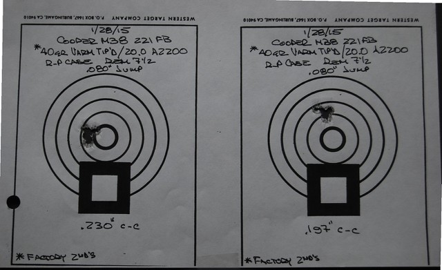

After a lifetime of rat shooting, I've come to the conclusion that the small FB case may be the optimum for this purpose. My 221FB and 20VT are two of the most accurate rifles I own, both shoot under 1/4" with their pet loads.
Not BR accuracy by any stretch, but my little Cooper M38 is pure rat launch material in the rat patch!
I suppose there's rifles out there that shoot better, but this accuracy is "good enough" for me. :)
